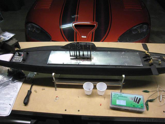

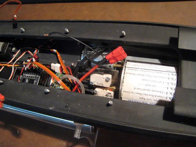

I haven't had a lot of time to take a really close look at things, but I can already tell that this model will need work to get working properly. The periscope system is completely seized, and will need to be cleaned with brake cleaner to remove a buildup of paint along the sliding shafts that keep the assembly aligned. Additionally, the TAES dive module, a benchmark of engineering that Engel developed that allows static diving to a maximum of 1.8m and allows the model to hover at any depth, is not connected or functioning. Diagnostics will need to be employed to see if the board is fried or if it is a wiring issue.
In the meantime, I'll play with getting things cleaned up and learning how the model works. There are a lot of electronics in there....

I haven't updated this page in a long time, but I'm happy to say that I've made enormous progress on getting this model operational, and it is now ready for duty!
I have done a lot of work to it in the last few weeks including:
* Install reversing switch for periscope system
* Installation of external power switch for main power and receiver
* Test trim, install flotation foam and ballast
* Correct kinked ballast tank hose for forward tank (this was a huge job!)
* Install ballast control board (TAE)
* Adjust linkages
I've had the model in the pool and its working perfectly. The chlorine content of my pool and its (relatively) small size made full testing hard, but as far as I'm able to gauge, its working great and its a really impressive model! Check out the videos and photos below!

I've been playing with this model on and off for a while now, and I'm glad to say that the odyssey is nearing an end. I had huge issues getting everything to work properly. The Engel kit is very complicated, with many redundant fail safes. In the end, it turned out that old batteries were the culprit for a lot of my issues. A kinked ballast hose was replaced along with all three batteries. A battery eliminator was installed so that no separate receiver battery needed to be used. All that is left now is final testing in my local pond and I hope to have that done this week. Stay tuned!
